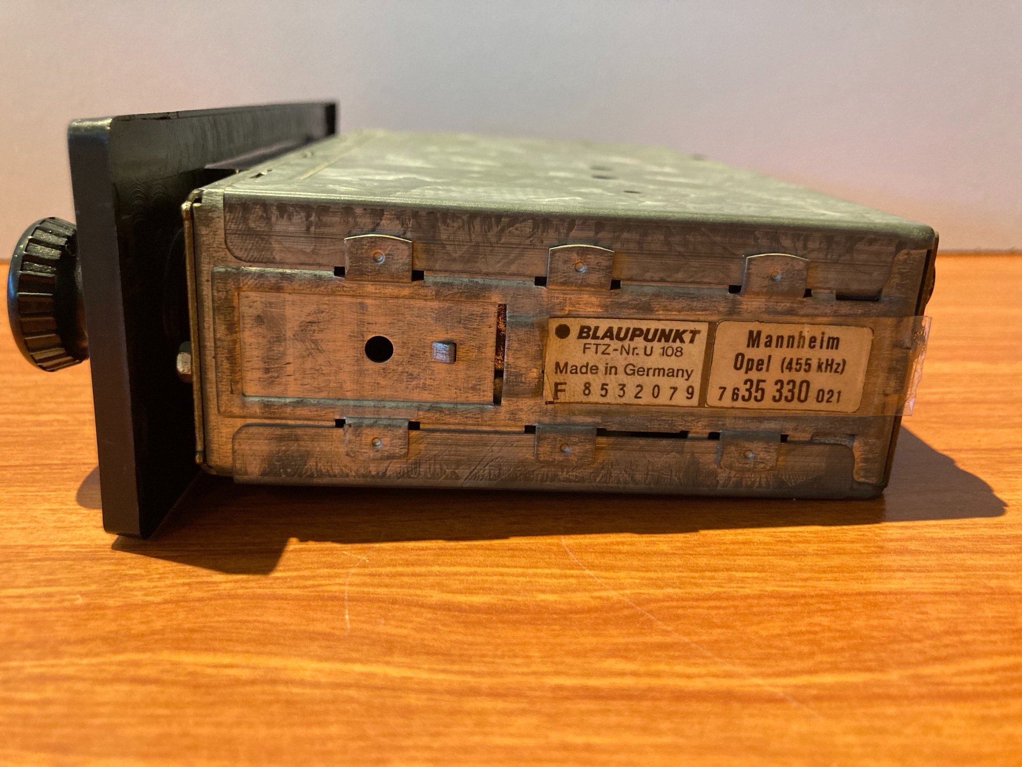

Just got this beautiful Blaupunkt Mannheim L :D
Period correct to replace the atermarket one that is still in there. AND! operates electric antenna! :D :D AND! DIN connection to Smartphone/MP3

only drawback: the radio bezel does not fit in the C Rekord. There the bezel tapers. you can see that a little in the picture

I already thought about that. When I get to have the car near me I´ll think about that part.... :mrgreen: Anyway, it was tooo much good deal to let it go. By the way, which radio and bezel is that?

should be this one: Blaupunkt Frankfurt

I´ll change/ create a new bezel and I think it will work perfect :D

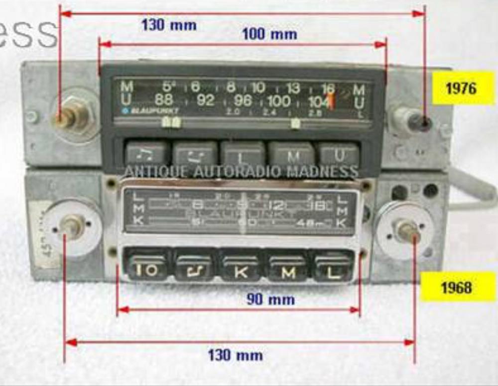

There are Dashboards for two Basic Types of Radios. In Germanys we call it DIN Schacht.
Don´t know exactly when the Break is but´s possible that the Blaupunkt Frankfurt from the Link is too big for your Car an you have to work on it. In the Plastic and also in the Body. Early Shafts are smaller.

the Brain hat geschrieben: 09.12.2022, 11:33 There are Dashboards for two Basic Types of Radios. In Germanys we call it DIN Schacht.
Regarding the knobs I think it will be ok.
The car has a aftermarket radio installed at some point. I don´t know yet if changes where made on the console itself. I don´t even know how the car is originaly on the radio opening

the radio bezel is not rectangular but somewhat trapezoidal - the control panel shown is rectangular...that fits....
the radio is inserted into the dashboard from the rear, the radioblened is put on from the front and fixed with the two cap nuts - you won't see them anymore after mounting the controls
